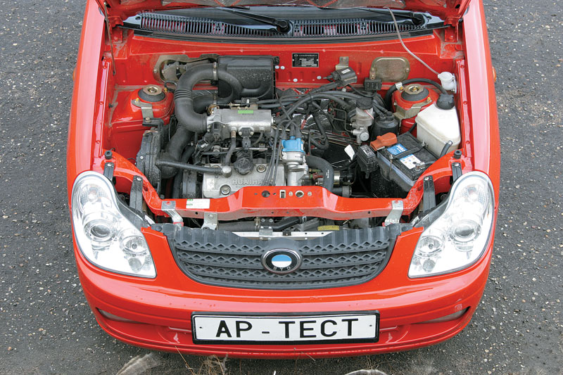

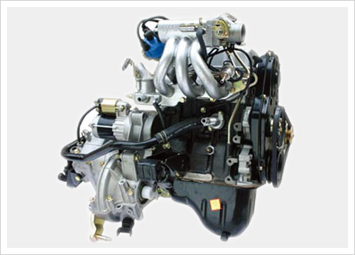

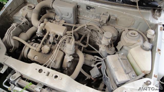

so BYD flyer motor engine fit the oka 1113. if you could show me any photos about that. we have this type of car here in Egypt. finally what is your opinion to me . do you recommend me to buy flyer engine .
 Заголовок сообщения: Re: greeting from Egypt
СообщениеДобавлено: 07 апр 2014, 13:20
I think, yes. But don't know exactly. I have 2 cars: Oka and Flyer, and I see that these engines have similar dimensions. Maybe Flyer engine is a little higher. Also, I know, that Flyer engine is Alto/Tico engine, except injector. BYD has made a few Flyer cars, so they or their original (BYD) parts are hard to find. I'm not sure that You can find it. IMHO, easier to find Tico/Alto. Or Daihatsu Mira (Cuore) L70, L200, L500 or L700 series. It has same engine too. By the way, Daihatsu Mira was a prototype to Oka.
Anyway, You can try. At least, You can measure the engine before You buy it.
I can shot my engine for a few days. Now it's not mine photos of Flyer engine:

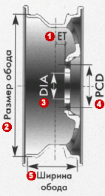

R13... You must know DIA, PCD and ET dimensions. So, VAZ R13 wheel is: PCD = 4x98, ET = +40, DIA = 58.1. Oka R13 wheels with 4 mount bolts have same dimensions. Any other R13 wheels with this dimensions and similar width will be compatible too. Also, hubs, brake disks and drums must have same PCD and DIA dimensions.

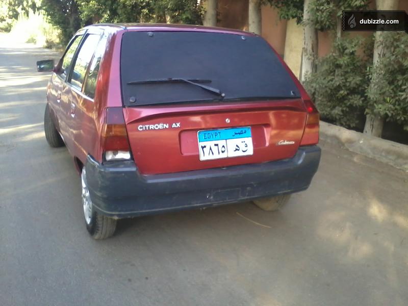

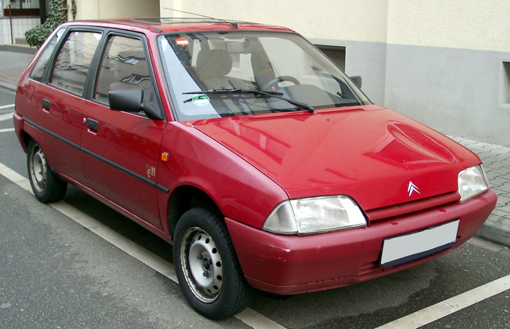

for example Citroen car AX of r13 rim and three nut does this car front disc and rear drums and rim fit for oka 1113
f2a088cd-11e2-4685-b4d9-4ec851c01301.jpg [ 28.6 КБ | Просмотров: 15852 ]
main.jpeg [ 53.26 КБ | Просмотров: 15852 ]
url.jpg [ 370.29 КБ | Просмотров: 15852 ]
СообщениеДобавлено: 09 апр 2014, 13:50
Citroen AX is: PCD = 3x98, DIA = 55, ET = 20. Oka (3 nuts) is: PCD = 3x98, DIA = 60.5, ET = 40. Well, You can fit this wheels with spacer, that will compensate DIA mismatch and centering the wheels. Perhaps, brake drums will fit to Oka (need to know dimensions of bearings inside drums), then You must use Citroen wheels and brake pads (Oka R12 wheels are not fit to this drums). But maybe require to rework the whole brake mechanism.
okay firstly, i can't understand you mean this cannot be done or what. secondly, what you mean by rework the whole brake mechanism. thirdly, from where (How) i know the dimensions of bearings inside drums for citroen (you mean by drums the rear or front?)
СообщениеДобавлено: 09 апр 2014, 16:50
You can fit Citroen's wheels to Oka (rear and front). In this case You must mount spacers between wheels and hubs.
